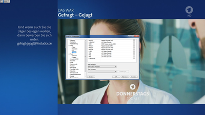

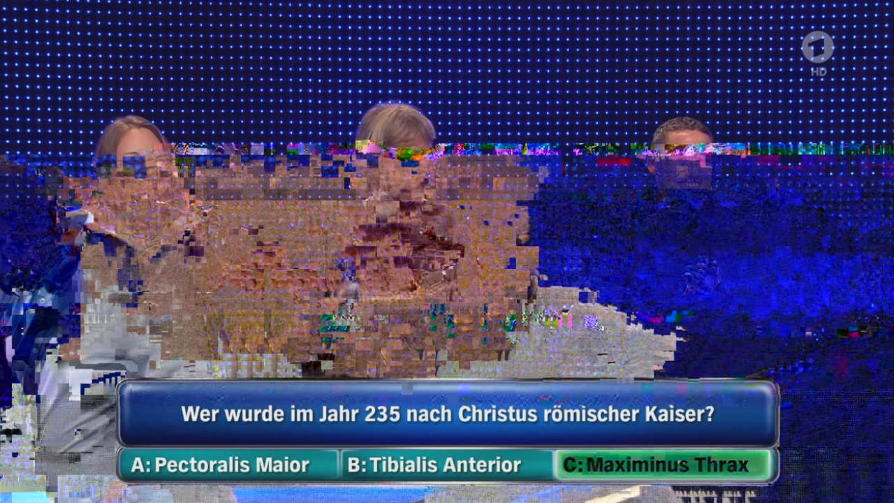

#20Installing the LAV-Codec and restart using the LAV-codecs are better than before, but not so good as it was bevor.
Hardware is definitly ok, when i watch other HD-Movies on youtube.com or mediathek.de ist absolutly clear picture.
Btw. in all chaannels the loss is 0,0%
What can i do ? Actually it looks strange (see attached pics).
Added a pic with actuall videocodec settings.

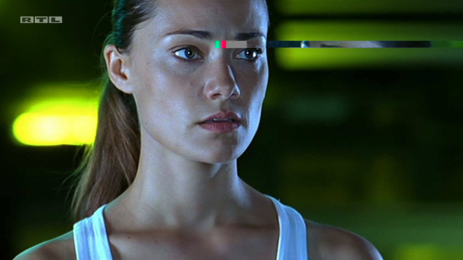

#21And that is, what i have in viewing normal cahnnels (not HD). See attaced screenshot with the stripe in sthe upper right.

#22try change demux on first page of settings.
ps: in LAV you can change deinterlace mode and hardware acceleration
