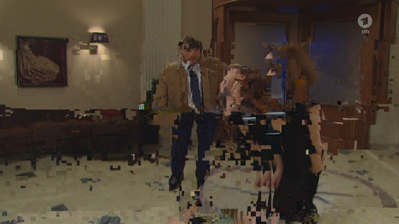

#4I found it. At normal channels it looks like this min lost 3 384 (0.1%) in HD-Channels i cant see it because it is flickering with no response in the headline.
Re: Problems with viewing HD-Channels (7.23.08)
#5is it possible check value on HD channels? You can disable playback of channels on first page of settings for stable working on bad traffic.

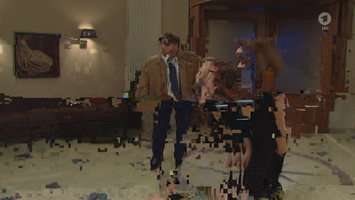

#6Without playback there are 0,0% loss. For example i put a snapshot hoow HD-channels are on this reply.

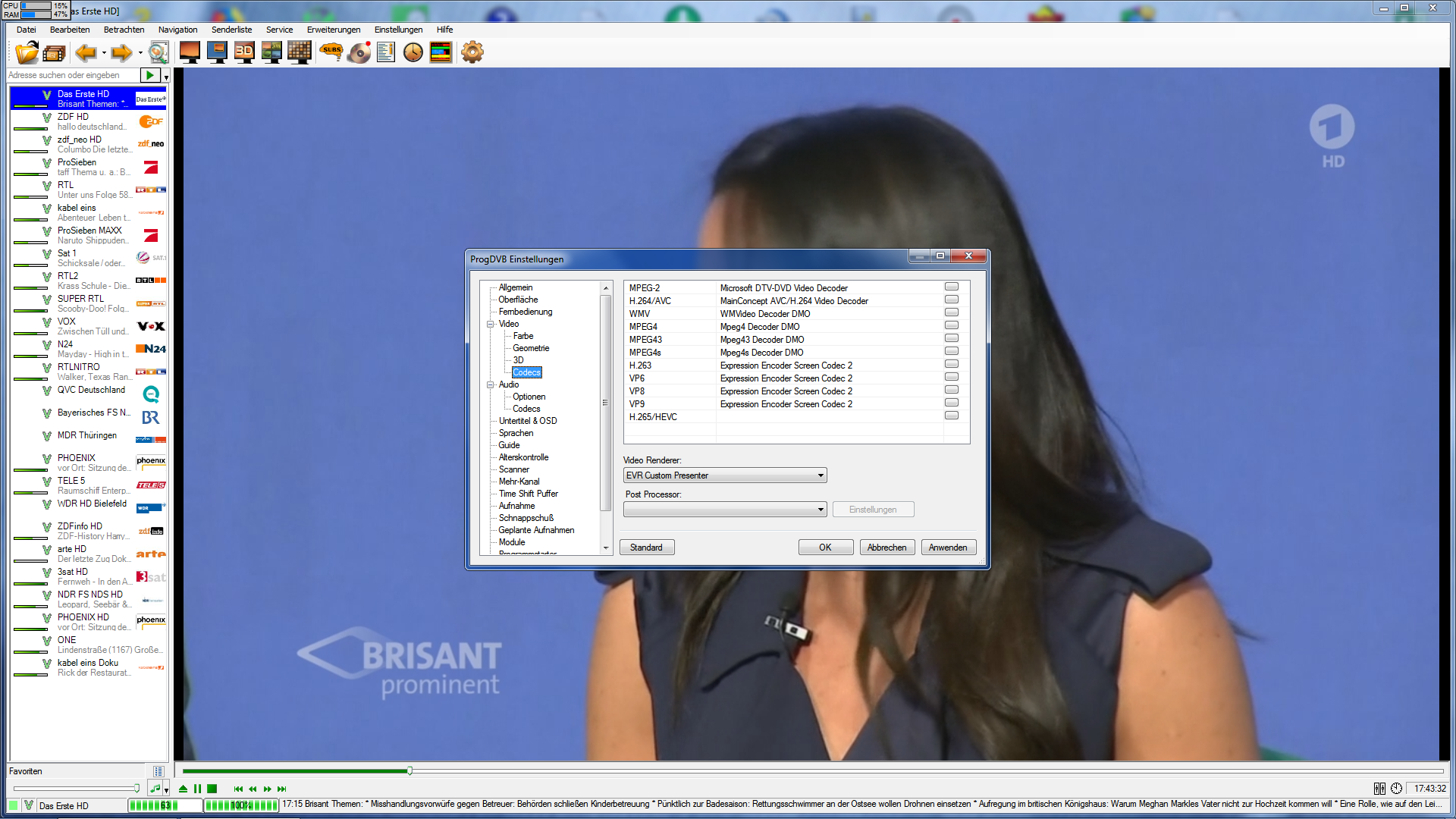

#12I have set H.264/AVC to the corresponding codec, also the next three, i`m actually experimenting with the first MEPG2.
#13I have taken a screenshot with my actual video codec setting.
What is wrong for viewing HD ?
#14You can try other codec for h.264. For example install LAV or select Microsft. Of course if this h.264 channel
#15Where can i download LAV, i have only this one and one other codec in this dropdown menue.
