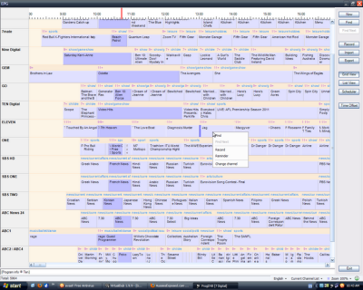

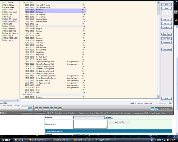

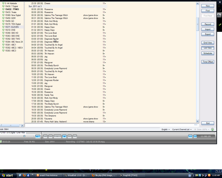

Thanks for the reply, I did what you said and removed everything in the channels folder including the "Youtube Logos" folder. I rescanned the channels and then took a look at the EPG but there is still the same problem happening as you can see from the screenshot. See how I moused over a program called "Jag" and it highlights the second Jag which seems to be layered underneath for some reason. See how it is happening for todays listings and only some of tomorrow
