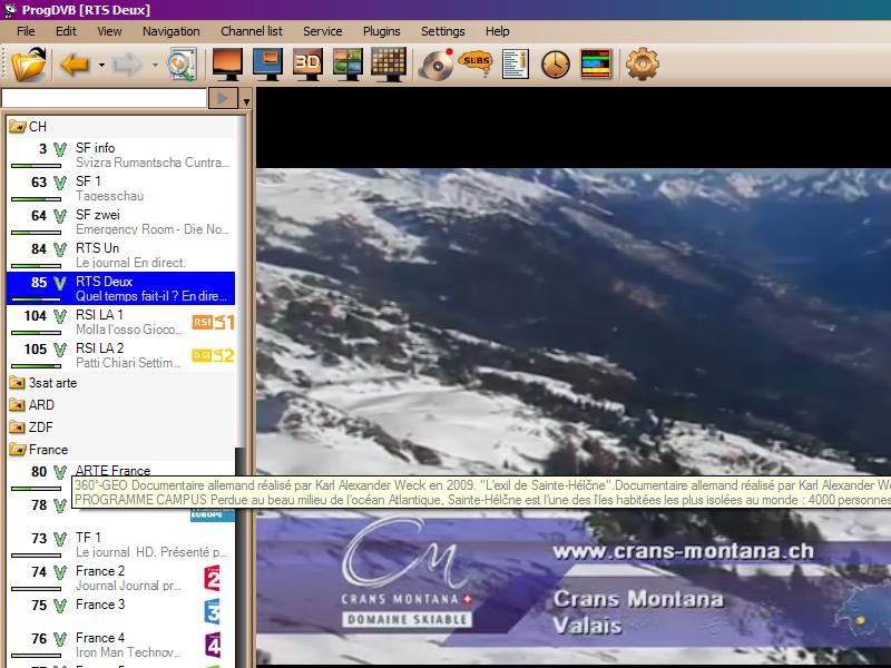

Please see EPG comment; Program running is RTS2, cursor (invisible) is over TV5 – EPG-Info for TV5 is popping up ... instead of french è there is slavic č (c with haček): "Hélène" would be correct ...
Btw: I had to crop the pic as you only allow 800x600-pics and not 1024x768 ...
edit: could it be that the pic was not displayed because of the haček in the name? now no exotic letters ...
... or does the used font have a wrong letter at the place of the è?
#1412This is one more problem with codepages. Every provider have self specific. I need 3-5 sample of TS. Service->TS recorder->All pids.
#1413Hm ... that is generating huge amount of data (ca. 3MB/10sec) ... what do I need to do exactly?
#1414Yes, I need sample of this transponder. It is dvb-s? What satellite?
#1415How long (how many seconds) do the samlpes have to be? And where do I have to send or upload them?
No, it's DVB-C and DVB-T ...
Btw: DVB-T gives 30MB/min. and DVB-C gives 240MB/min. when selecting "all transport stream"
#1417so your ftp is ready for ca. 2GB of data? ... ... please wait a moment while uploading (see folder with my user name)

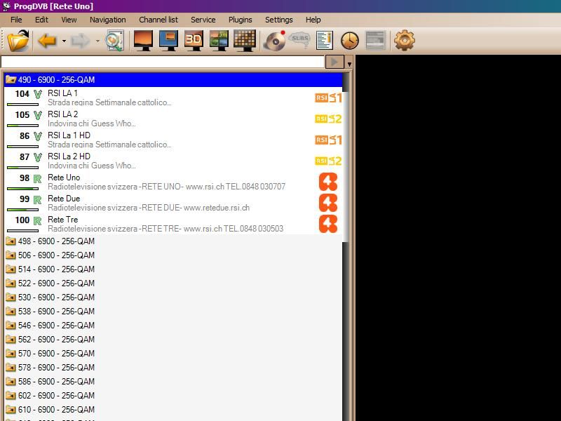

btw: some other issue: wrong icon for radio-stations of swiss radio in italian language (all got icon from Mediaset-TV-Channel Rete4 (that's one of the channels of Silvio Berlusconi); but swiss radio in italian language does not have anything to do with that – see pic and the weblinks:
http://www.rsi.ch (please scroll down):
http://reteuno.rsi.ch/home/networks/reteuno.html
http://retedue.rsi.ch/home/networks/retedue.html
http://www.rsi.ch/home/networks/retetre
vs.
http://www.mediaset.it/rete4/ (the TV-Station from Silvio Berlusconi
vs.
#14182Gb is not problem. But logos is very long story. I am not can know all channels in world (in every city...)
#1419I assume there is some automated system that for a channel name beginning with xyz, automatically icon is of other station beginning with same name ... leading to that result ...
#1420I check 482_H_6900 DVB-C.ts. Is it 28598 correct codepage for your region? Or what file best?
#1421Nope ... codepage must be for western europe (german, french, italian, etc.), so looking here to that codepage list I assume 850, 1252 or 28591 (iso-8859-1) should fit ... but be aware: we have also a frequency with russian, chinese and thai program (packed into one "DVB-C-transponder") in our cable network (but they don't have EPG).
