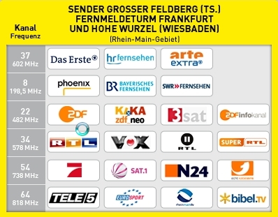

#7Thanks. Can you guide me on how to configure/scan DVB-T for region Germany, 63225 Langen?
Re: DVB-T (terrestrical) Support for AVerMedia AVerTV Volar
#8My terrestrial antenna does not reach that far.
For details on your transponders try www.ueberallfernsehen.de
#9
...how do I have to use this info now, I'm not an expert.
#10transponder = frequencyJuergen wrote:Prog meant to test by scanning just one transponder manually.
so manualy scan the frequencies shown on the left side ...
