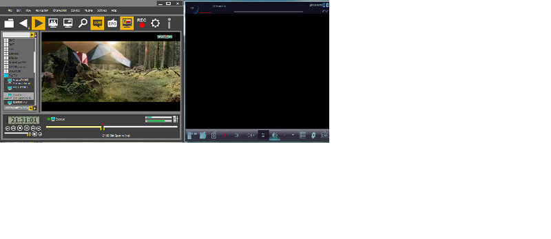

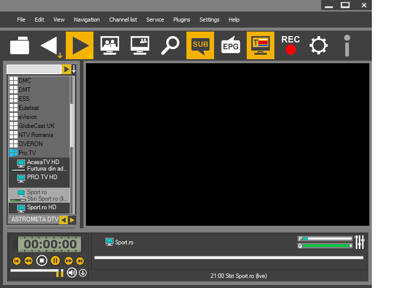

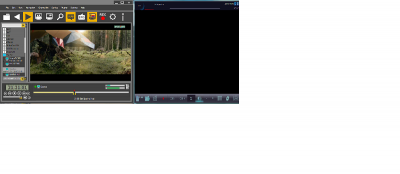

This appears to be a new cheap device (for DVBT-2 support at least) from china, I've bought one myself. It has a Realtek 2832U chip in it. The drivers supplied with it seem to only expose the DVBT2 tuner (or at least, it's only finding DVBT2 channels even if showing as DVBT). The channel information also appears to be garbled. There is a program shipped with the device (shown in the screenshots above) that allows you to view all the channels properly (with those same drivers). But it's a limiting program and I'm sure we'd all much rather use ProgDVB.
I would be happy to offer any information that I can in an effort to possibly add support for this device.
