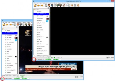

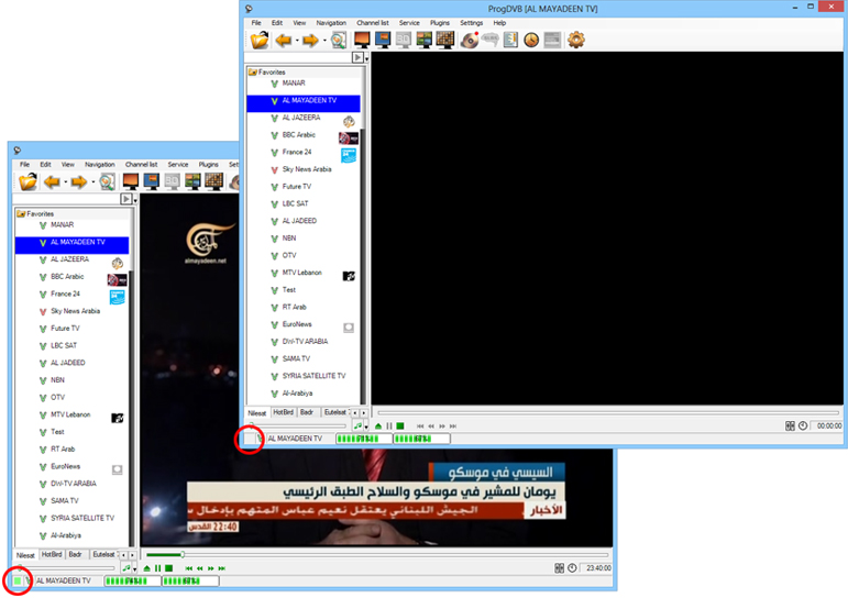

Attached are two screenshots showing the green square at the corner when it's working, and the green square disappear when it's not working. However, there is signal on all the channels and satellites that i have!

Re: SkyStar 2 eXpress HD, signal ok but channels not opening
#4"green square" mean traffic. You have signal level but no traffic. Looks like driver problem. Try update/change driver. Also try change pci slot.
