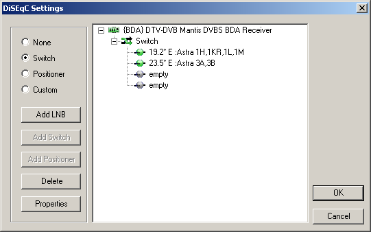

#508I think I found a bug,
I use an Azurewave SP400 DVB-S2 card together with a 2 port DiSEqC switch (Astra 19.2 & 23.5) and my operating system is Windows XP SP3.
Since version ProgDVB6.46.6Std upwards I experience difficulties using the 2-port DiSEqC option (22 Khz, switch 2 ports) I do not get a signal at all.
However if I use the 4-port DiSEqC option (DiSEqC 1.0 4 ports) and only use the first two ports (for 19.2 and 23.5) I do get a picture! But I do not own a 4 port DiSEqC switch, I have a 2 port DiSEqC switch. (using ProgDVB6.48.3Std)
- DiSEqC 1.0 4 ports
- DiSEqC.PNG (10.92 KiB) Viewed 8071 times

#5102 puch-maxi: Do you really like use 22khz? Becuase this type of diseq not compatible with universal LNB.
