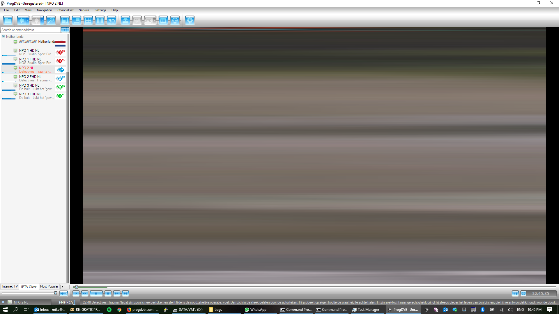

However, during testing multiple channels have the video as shown in the picture below:
What could be wrong? Is this a license issue? A missing codec (or wrong selected codec?)?

Just wanted to confirm that the combination of changing codecs (to LAV) and video rendering type (to Enhanced Video Renderer, instead of the EVR Custom) has resolved this specific issue.
