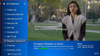

Here's my example -
Screenshot #1: I was watching The Weather Channel, and pressed OK to open the list of channels...

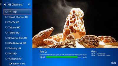

Screenshot #2: I used the up arrow to scroll through the list of channels and stopped on TNT but I did not tune to that channel. Instead, I closed the channel list and stayed watching The Weather Channel...

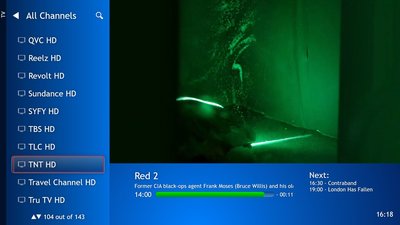

Screenshot #3: But when I press OK to open the channel list again, it should be back at The Weather Channel, not whatever I was on before I closed it last time. But you can see that it opened back up to TNT instead of The Weather Channel...
I think it would be good to at least have an option whether or not I want the channel list to remember my last position, or not and reopen to what is currently tuned. Does that make sense now? I hope so because I don't know how else to explain it. lol
