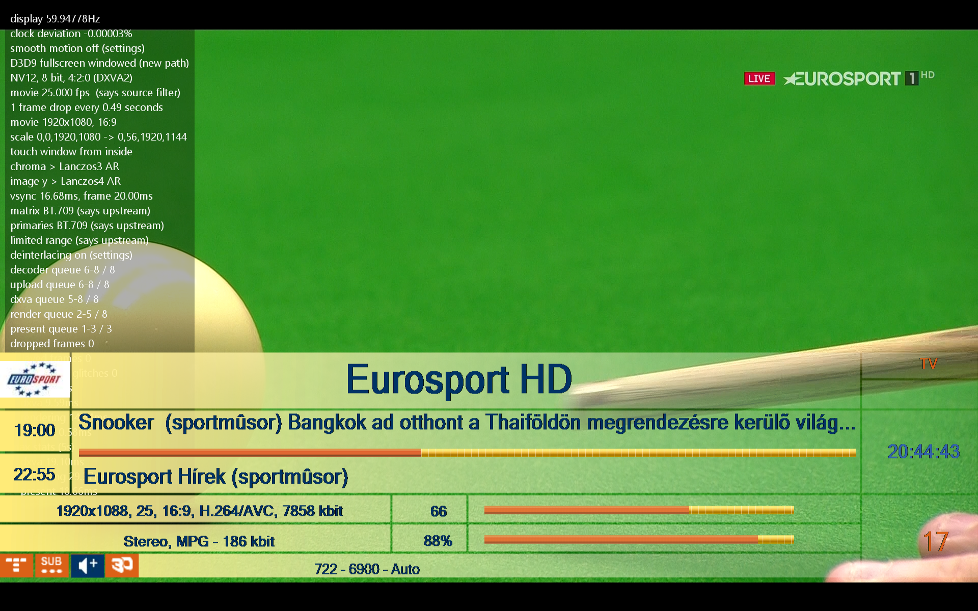

Afaik madVR not support API for OSD like Microsoft renderer.
I don't know what you mean by this, but I know that HD skin works with madVR temporarily if I start ProgDVB with EVR than change to it. The only way it works.
So I don't think there's anything wrong on madVR's side in this regard.
See attached picture:
