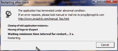

Both free versions (32 and 64 bit) crash permanently on Vista 64 Ultimate and Win7 64 Ultimate during the loading process even after a reinstallation from scratch. This has been happening since at least version 6.70.

#3The main window doesn't even start, I only get the attached message.

#9There are no log entries (where should they be?) as the main window does not start but only the already reported error message is shown.
