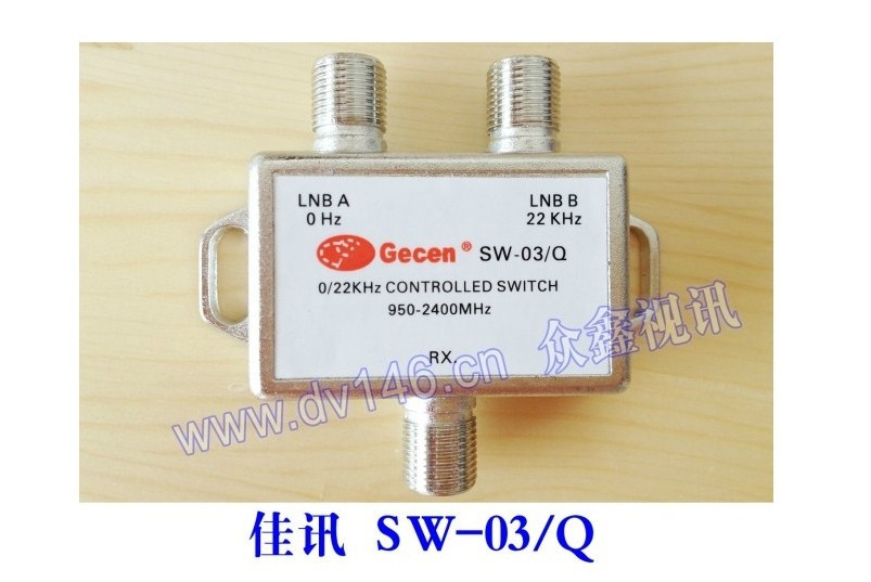

Hi,
I bought a couple of 22KHZ multi-switchs that I want to use to get more than 8 satellites using a 8x1 Diseqc.
This one:
As a test I'm connecting Nilesat 7W to input A and Hotbird 13E to input B to the switch.
It does not seem to be working.
What are the LOF1 SW LOF2 Settings should I use for it?
Thank you.

Thank you for the reply.
But it does not seem to be working.
Nilesat is at input A with 0 HZ. This one can scan transponders up to 11766 after that all the scanned channels is that of 11766.
Hotbird is at input B with 22 KHZ. This one does not show any channels when scanning.
Current Configuration:
Diseqc 8x1:
Port 1: 22KHZ Multi-switch
A 0HZ Nilesat
B 22KHZ Hotbird
Thank you.

Prog wrote:Afaik impossible use both band over this switch. 22khz must select low or hi band of LNB
So this switch is not made to be used with two KU Band Universal LNBs, is that correct?
Another question: How can I connect more than 8 lnbs using 8x1 diseqcs?
