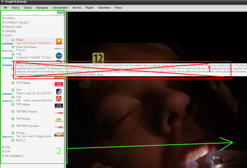

Hi,
I have 2 questions about channel list window. Is there any way to:
1. Not display actual program EPG info.
2. Move channel list window from left to right part of main window.
BR

Re: 2 questions about channellist window
#3Thanks for response Seba. Your suggestions weren't what I wanted but it gave me some ideasseba wrote:1. Go to the Channel list properties (right click menu) and enable Compact Style.
2. yes and no. It depends on the skin. Check the other available skins.. some of them have the channel list to the right.
If the Show panels is enabled in full screen mode you will have the channel list available on both sides. Depends where your mouse pointer hovers.
1. Disabling compact styl I will loose logos and short EPG info. I only don't want this big EPG info "baloon"
2. I don't want to change current skin because I like it
So, I decided to edit my current skin
SkinEditor.exe --> MainForm --> mLeftPanel --> Dock.
I've changed it from "Left" to "Right" and it works perfectly!
Thanks!
