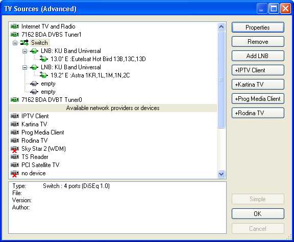

You must setup diseqc switch in TV Sources.

Is this configuration correct?
By the way my DiSEqc is 2.0 as can be seen in one of the previous screens
  • Wed Apr 02, 2014 7:03 pm
26180
Re: Lifeview FlyTV Express X1MST-STA2,PD no tuning on ASTRA1
#28 by Prog
Correct. Now you can try look good mode in Settings->Device options.
