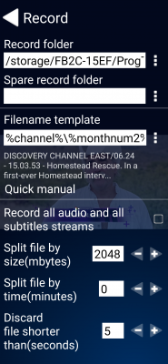

So, how to record on an USB.... By searching in the forum I found this (viewtopic.php?f=13&t=10468):
1. Find out the name of the package corresponding to the ProgTV app i think it's com.progdvb.progtva
2. Create a folder called 'Android/data/com.progdvb.progtva on root directory of your USB drive For example, Kodi data directory is /Android/data/com.org.xbmc.kodi/
3. When you are going to record a new show, select this new folder for recording. If I'm not wrong, the app will have write permission and you're done.
Or what is the solution?
If I should follow the above then how do I do step 3, select this folder?
Regards, Pedro
