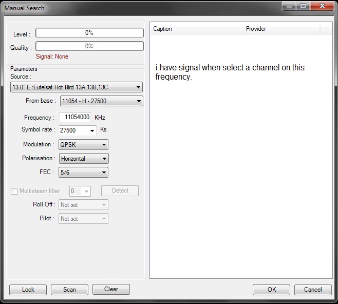

problem with progdvb 6.91.2 in Manual Search , when i go to Manual Search it take a lot of time to open this window (not responding...) and after it open there is no signal (signal : none) , when i click Lock , it lock on the tp and become green but after 1second again automatically saying signal : none. but i have good signal on all frequency's and i can watch channels with progdvb before was scanned , same with full satellite search ...
also some times on some channels which have no PID and need to update , when click on Update button in channel properties window , progdvb will crash...
Windows: 7 Service pack 1 , 32bit _-_ DVB: Sky Star 2.8a PCI _-_ CPU: 2.6 GHZ Dual core X2 AMD _-_ RAM: installed 4Gig , 2.75 Gig usable _-_ Graphic: ATI Radeon x1200 series total available memory : 1663
