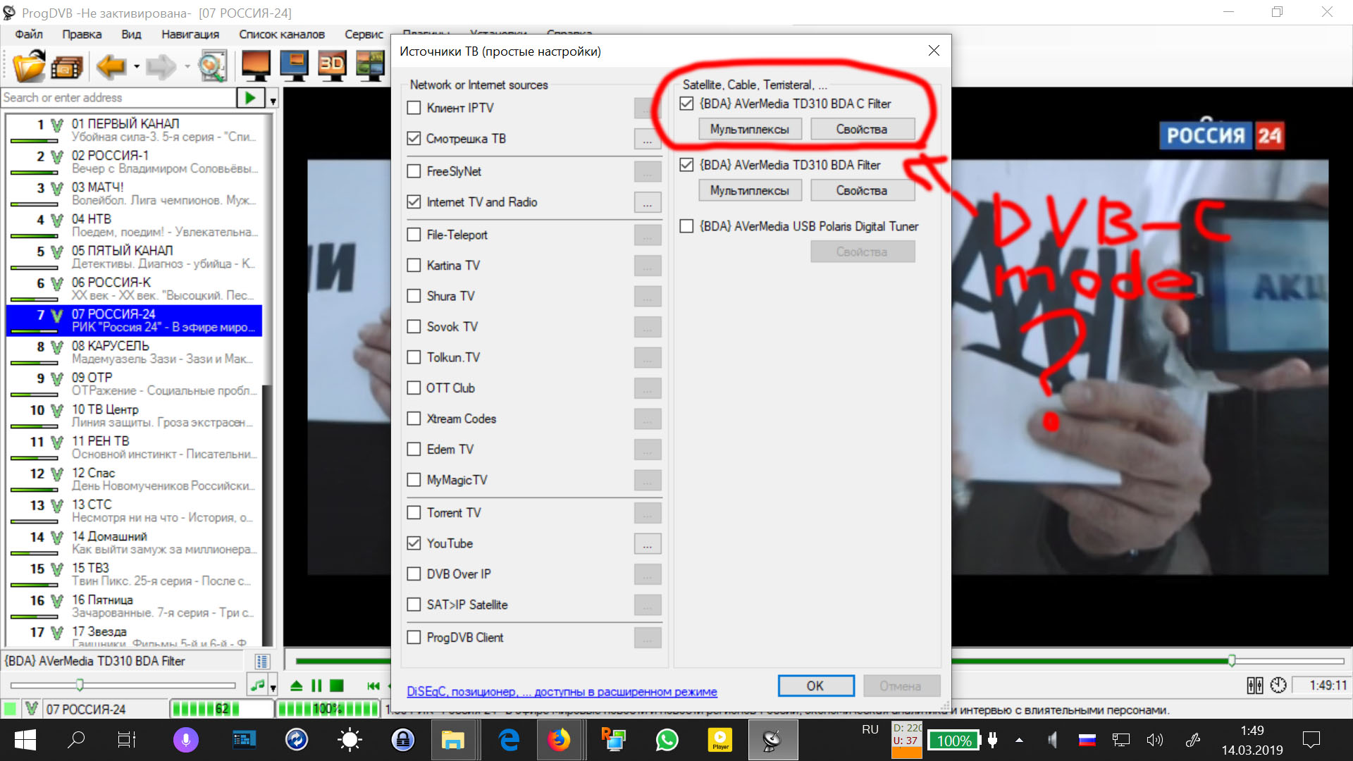

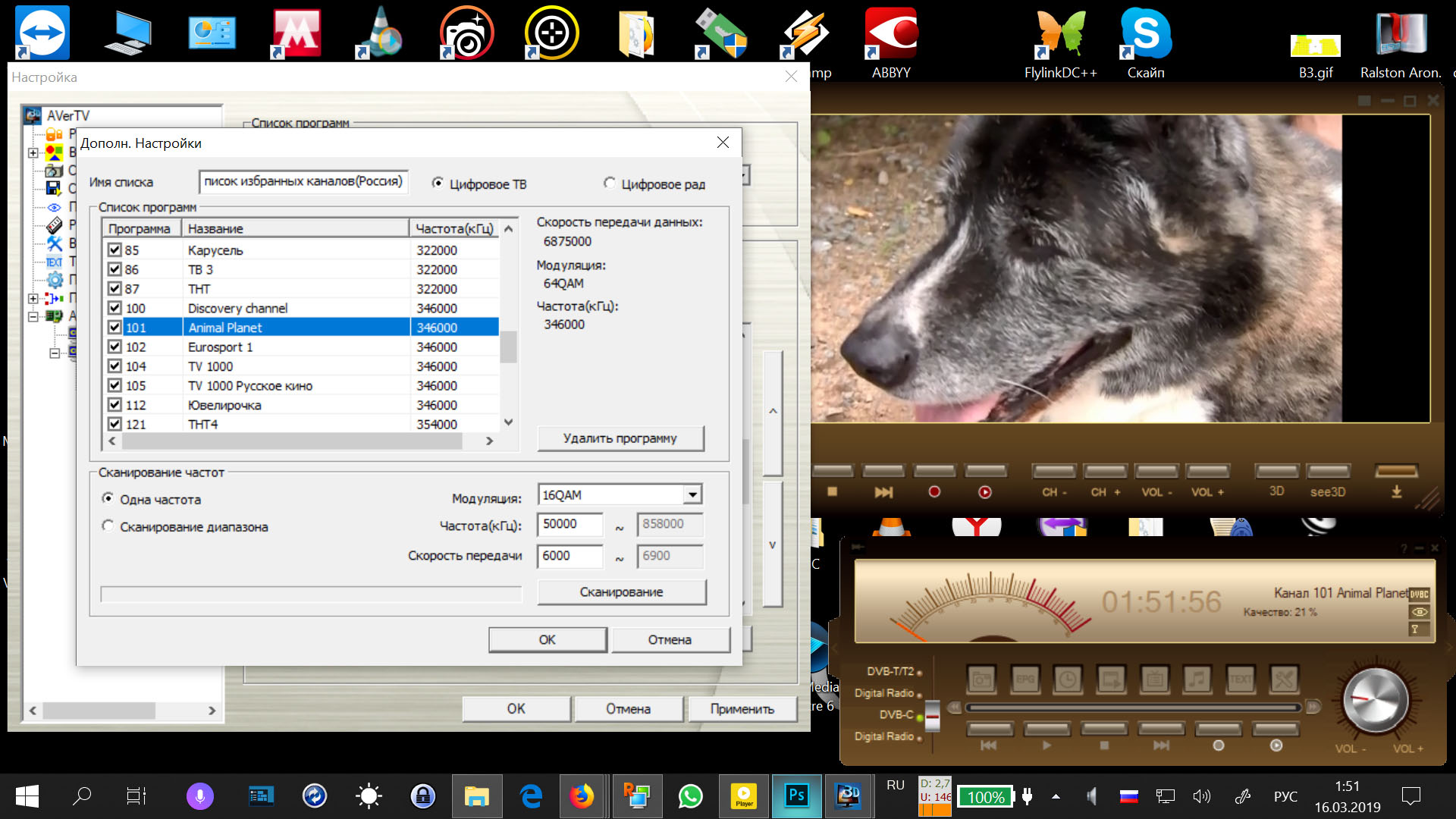

I also hope to understand how to make the DVB-C mode work in the td310 (in the official software Avermedia works), because I still have some cable channels on the cable network.
But about finding cable channels, unfortunately, does not find any (although the native software Avermedia finds)
I will try to look if I can find a way to switch from dvbt to dvbc in driver.

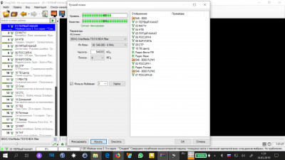

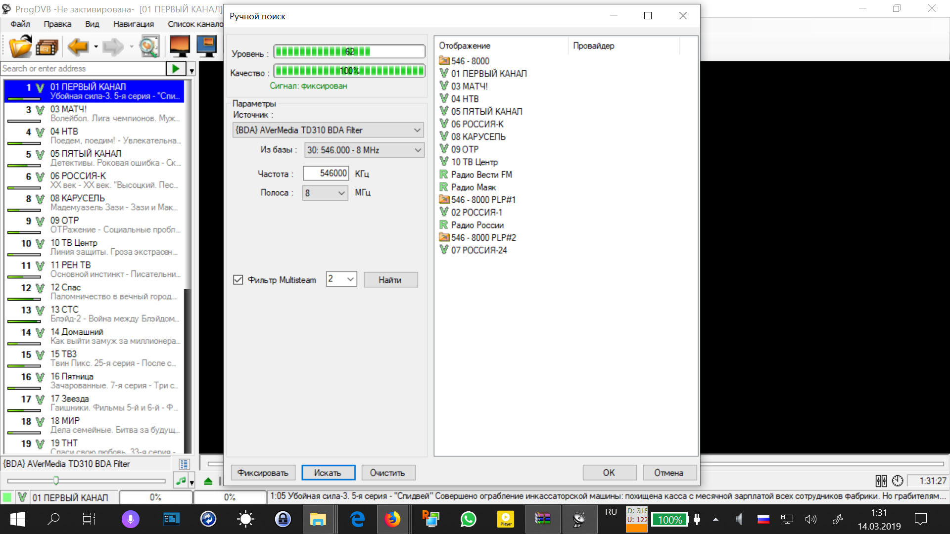

#41
Greetings!
Did as you said in the TV sources ProgDVB
{BDA} Avermedia TD310 BDA C Filter - chose
{BDA} Avermedia TD310 BDA Filter - uncheck
I tested your file. But, unfortunately, the channels were not found. I attach the logs, although they are very small. Another point is that the logs would be saved, as we know, to run the ProgDVB as an administrator. In this mode, I can not enter the manual channel search - the ProgDVB crashes (Under the adminstrator, only a full automatic channel search worked, although the channels were not found). If I run as a regular user (he is also an admin), manual search works, but still does not find cable channels.

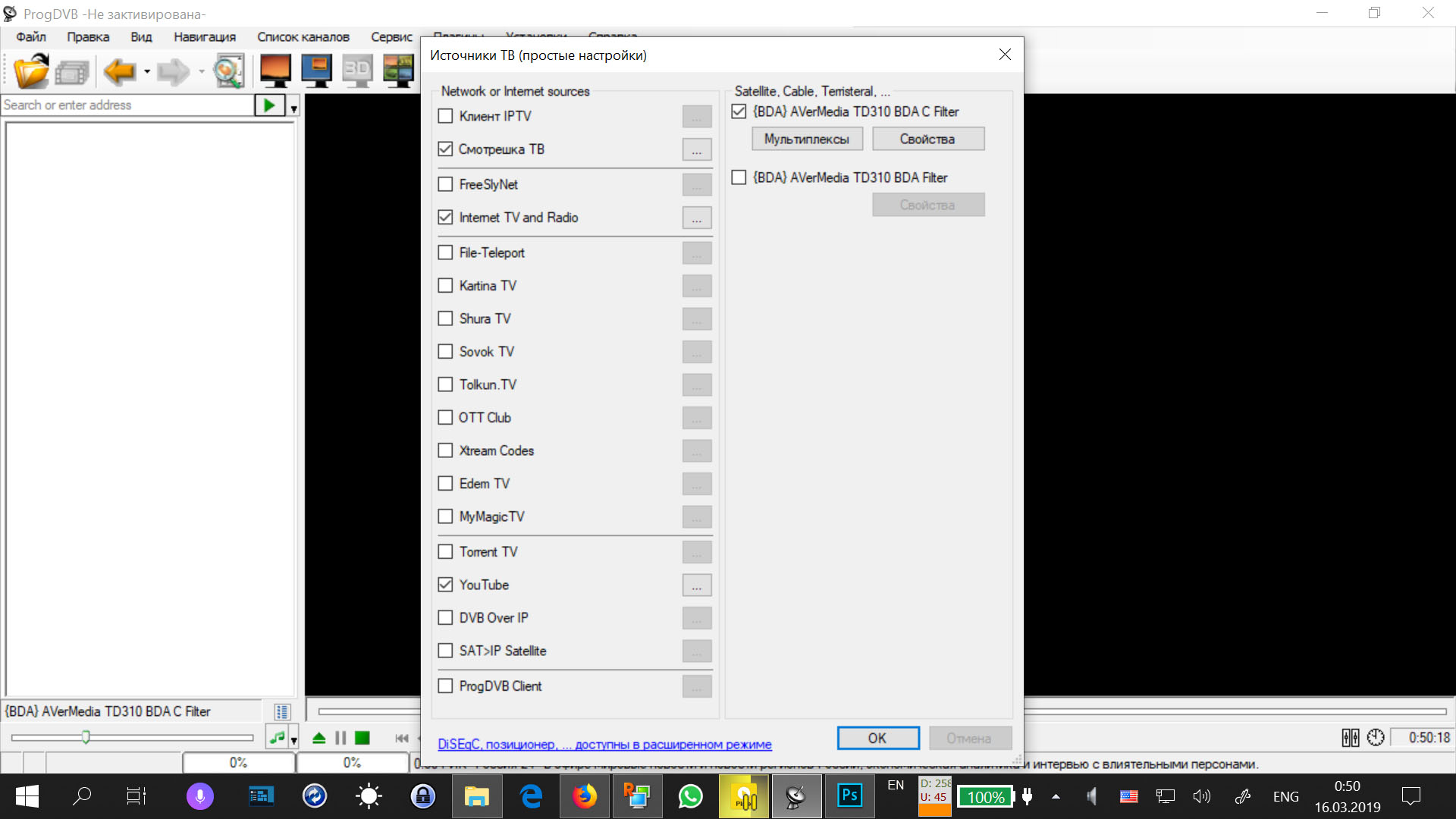

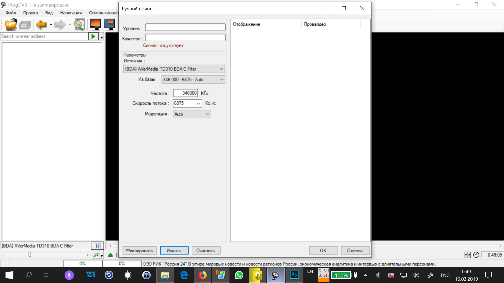

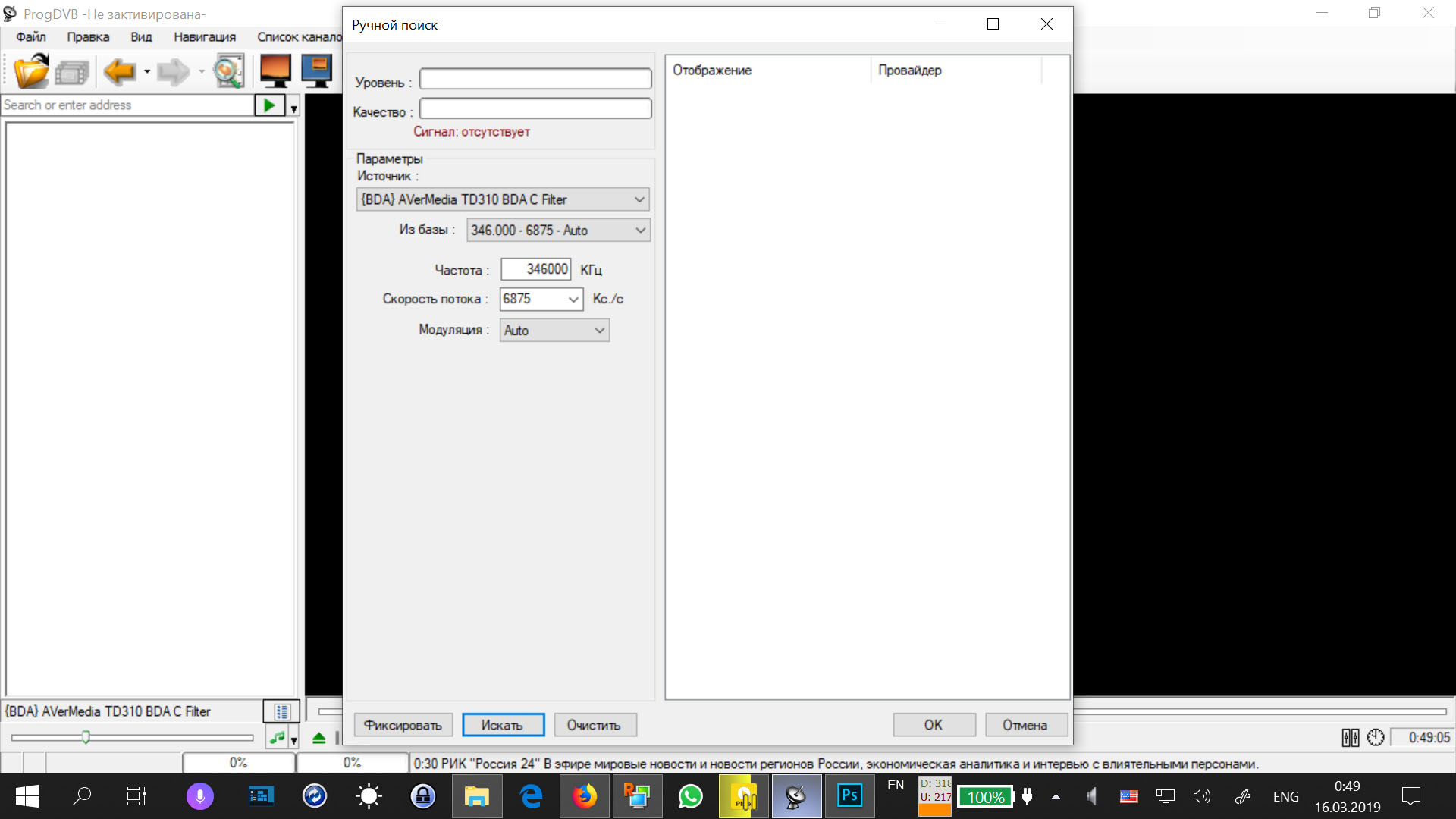

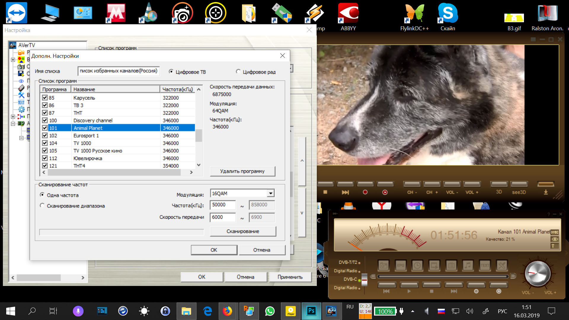

#45
crackname wrote:
Thu Mar 14, 2019 9:23 pm
Hello,
The log doesn't contain any Before/After transponder lock, it's like no scan was made.
Please try the new attached file, this one use the Blindscan interface that avermedia use in there software, if it doesn't, I don't know what will !
Alas, but unfortunately, the tuner stubbornly does not see DVB-C channels when searching in ProgDVB. Moreover, I tried to even explicitly specify the channel frequency, which I determined from the channel search settings of the official Avermedia software. Here are some screenshots for example and logs.
