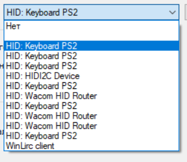

Yes, I also want to understand. And why does the remote control continue to work (with the glitches described in my last post) even if the control model in the remote control model section is NO? (see screenshot) There generally what should be chosen ideally (when using the TD310)?
And the question after. Why are there identical menu items in the list of RC modules, such as "keyboard PS2", and why are they repeated? (see screenshot)
It continue to work because the code that manage it is included in the avermedia.ebda module.
The name not displayed is up to how Prog is programming his software.
For the glitches; the code try to detect key repeat, that need to be disabled in the future.
