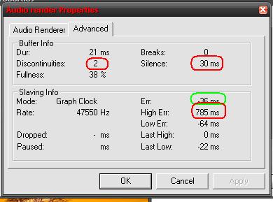

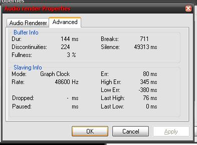

Here are the data for HD H264 channel with mp2 audio:

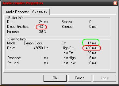

HD H264 with AC3 audio:
PS: It seem that you developed the code around these to codecs and for this reason I only got strange results with the other audio codecs. At least I have a working solution now. Thank you!
PS2: There is not change for the Prog demux, The small freezes from time to time are still present.
