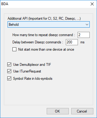

This dialog must be on 1.0 mode. But most important mode in Options->[device name]. Every device have self API for diseq.
Try Microsoft for example.

I currently use DigitalDevice API (my card is DigitalDevices) it's not important it is equal like original HW?

I have Progdvb pro 7.25.05
I tried all the Api options but none of them works.
Switch is setting on Diseqc 1.0 (4)
Any other tips for me?

You must select 1.0 diseq for this switch.

I have selected disegc 1.0
and I tried all api option.
but not working.
what next?
Re: DigitalDevices
Posted: Wed Oct 31, 2018 1:43 pm
One of option must work. Microsoft or digital devices.
Do you test other software?
ps: Also you can change "repeats" field in settings. To 3 or 5 maximum.

In dd driver was bug.After I installed new test version driver everything is good.
But one thing is interesting.
If I choose DigitalDevices or Microsoft API doesn't work only If I choose AverMEdia it is ok.
