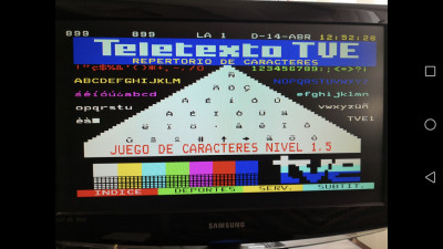

Thanks the most fix it is portugese, but anyway it fail in some letters. The tildes as í or ó. Or ñ.
Anyway i upload the character set taken from a tv. And how is show in progdvb, (nobody have the triangle characters.)
- Prog dvb in portugese
- How it should be taken from a tv

7.27.7a?. I have downloaded the professional version.i view in the tve page 100 yellow box, the I of indices was lost, also in the green box
I view it not display the blue back colour in the teletexto tve big letters in page 100. Also it lacks littlr colour block in red and yelow box of page 100
It also lost in all news for example in 103 just down the date between the two red lines the text "noticias"
And in 899 it continue not mostrating the triangle characters.

Not clear. Do you mean problem with codepage or Teletext 1.5 support?
Looks like all Spanish chars present. Or?
