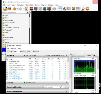

I use the progdvb many years. i never had any problem.
The last version that is working is 7.31.2.
All the versions after that are freezing on start. Some times if i force close the prog then when i start it again ask me to use the last working configuration and then works ok. The next time freeze again. I am using win 10 64. I am only use 86 ver of progdvb. I have the same configuration for years.

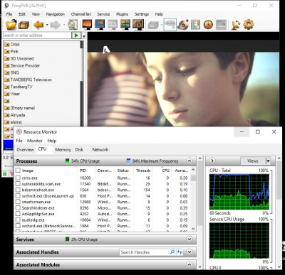

As you can see in the pic's that i am attaching when the prog freeze the cpu going like crazy.

#4I find it out. I send you one working 7.31.2 and one freeze 7.32.3 set of logs

#5Thanks. But no errors in logs. Is it depended from video renderer?
Laso try stop server and plugins and remote control module.

#6ok. i will remove all plugins and a will try. i have no remote. As i already say the 7.32.2 works perfect.
I will let you know.
