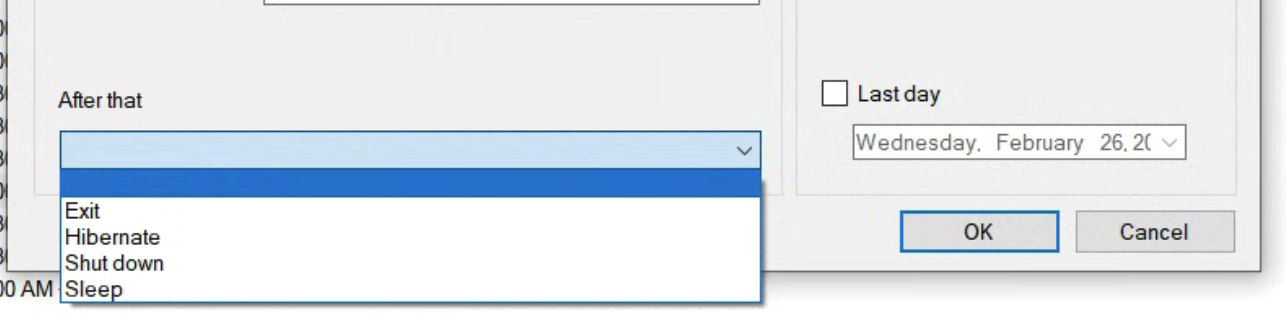

I believe that when a scheduled reporting completes, the channel stays open in progDVB until a user manually clicks to stop it.  This is a bit of a problem with IPTV because often you can only watch one stream at a time.   If my progDVB computer doesn't stop the channel when the recording is over, I cannot use my IPTV anywhere else until I log into this computer and stop the channel.
So my question is... is there a way to have the channel close after the scheduled recording completes?  Maybe one of these options does this?  But I think these all don't look quite correct for what I'm looking for.

#2Scheduler must close channel in any case. What mode of scheduler you use?
							Re: Possible to stop the channel after a scheduled recording?
#3Possible you right and need more one mode for close of channel.
#4That'd be awesome if you could do that @Prog.  I've tried with background record & with "open the channel" or "open in new window" but I haven't paid attention to whether one of these works better than the other for this problem.  If you could add the option to make sure it is closed when complete, that would be great.  Thanks for always answering so quickly on here, I appreciate it.
