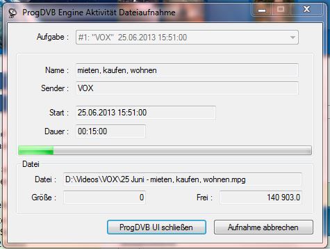

I previously have created a scheduled recording job using EPG and the program own scheduler. When the recording time has been reached I can see that the directory for the station to be recorded is created as well as the file with the name of the show. But the file remains 0kB :shock: .
Double clicking the Prog launcher opens the ProgDVB Engine Activity window which displays the progress bar, but it shows that nothing actually is recorded. I attached a screenshot.
When I click "abort recording" it doesn't do so. Even if the scheduled task actually is over I have to abort the ProgDVBService.exe using the task manager before I'm able to open the program again. :evil:
Next I tried what happens when I schedule a job and leave ProgDVB running without beeing started via the Prog Launcher. This worked fine. Directory and file were created, the file grew in sice :D .
So I assume the ProgDVBService.exe to be the problem.

Screenshot of ProgDVB Engine Activity window during recording session.
