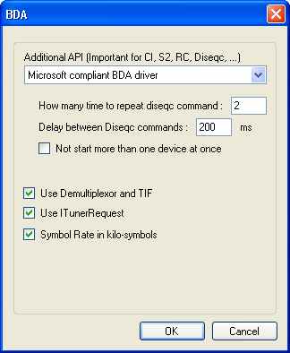

diseq switch? Check TV Sources and mode in Settings->Device options
Re: Lifeview FlyTV Express X1MST-STA2,PD no tuning on ASTRA1
Posted: Sun Mar 30, 2014 3:25 pm
by mittolo
Thank you for having responded to me. I'm sorry but I'm not an expert. Could you explain in more detail what should I do? I tried in Settings / TV Sources / Options and the only reference to diseq is: " Delay between diseqc commands > 200 ms " and " How many times to repeat diseqc command > 2 ". Can you tell me what should I do? Thank You.
Posted: Sun Mar 30, 2014 4:48 pm
I am mean mode options. For example try select Microsoft mode.
Posted: Sun Mar 30, 2014 6:44 pm
by mittolo
Ok. I tried Auto, Microsoft compliant BDA driver and Creatix/LifeView/.., but still no result :cry:
Next...?
Posted: Sun Mar 30, 2014 9:53 pm
by mittolo
I tried all the settings from "Microsoft..." to "Behold" and I also tried with "Symbol rate in k..." checked and not checked but...again no result. :x

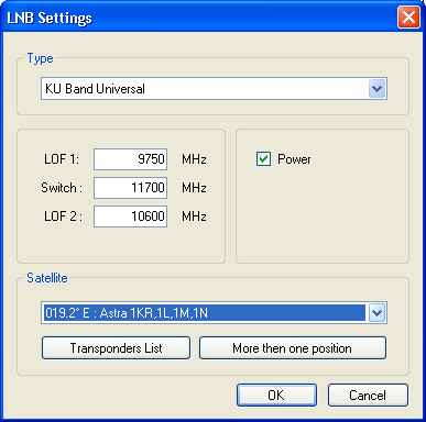

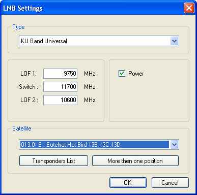

Please send me screen of TV Sources dialog in ProgDVB.
Posted: Mon Mar 31, 2014 11:37 pm
by mittolo
Posted: Mon Mar 31, 2014 11:41 pm
by mittolo
Posted: Mon Mar 31, 2014 11:44 pm
by mittolo
Posted: Tue Apr 01, 2014 5:41 am
Must be [DVBS Tuner]->[Diseq switch]->LNB1 & LNB2
