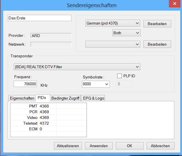

here some screenshots - is this what you need?
ARD (Videotext subtitles page no. 150)

here ZDF (page no 777)
