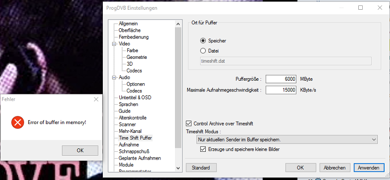

Seit einigen Updates habe ich die Fehlermeldung, wenn ich den RAM als Timeshift-Buffer eingebe diese Fehlermeldung wie anbei zusehen. Somit kann er nicht den RAM als Zwischenpuffer nutzen.
Woran liegt das. Vorher ging es doch.
Bei jedem Update verschlimmbessern die irgendetwas.

#3Ok, thanks, that was the problem. But where can I download just only the 64-bit Version????
The Download on the ProgDVB.Side is only the 32-bit Version, although there is marked both of the versions.
But if I klick the link it always starts only the 32bit-version.
Re: Fehler in buffer of Memory
#5Thank you much. But where is the Link for further Updates an Why can´t the Webside show th direct link? Why is this such a problem?????
#6Actually, the download link for the x64 version is right there on the download page. For ProgDVB Pro you have the download link "ProgDVB + ProgTV Professional for x32/x64 OS" for the 32-bit version which you already mentioned. And just one line below you have "version for x64 OS" which is a separate link to the 64-bit version.
#7Aaaaaah, I see. I thought it was just the whole link for both versions. But the 64 version has got a seperate link. Thank you so much for the tip.
