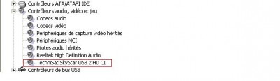

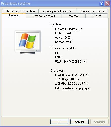

Hello;
I am experiencing this problèm with all programs i have tried
dvb-s channels works fine but no dvb-s2 channels
i am using the latest driver soft_skystar_usb2_hd_ci_v1_3_6795 from technisat
the pictures within this message shows my system configuration
please help me
thnks

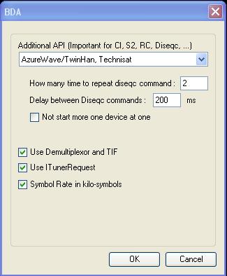

Check settings->Device options. Must be Azurewave selected.

#3 by ahyousoft
like this?
still the same pb

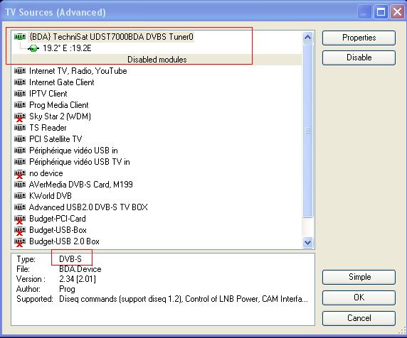

#4 by ahyousoft
by the way;
is this normal
it's showed as dvbs card
technisat UDST7000bda DVBS tuner??????
is there apb with the driver???
  • Thu May 05, 2011 12:19 pm
26195
Re: No Signal for Dvb-S2 channels using my Skystar USB2 HD C
#5 by Prog
Yes. Looks good. try Microsoft mode also.

#8 by ahyousoft
i am using this driver: soft_skystar_usb2_hd_ci_v1_3_6795
is it the same with you?
also the server4pc didn't install with it; is that normal?
are u running under windows xp sp3 also?
sorry for all these questions; it just that i have been trying to view dvb-s2 channels for a week now without any luck
i also use a laptop and a motor; does those affect?
best regards

here is picture of my driver configuration
and the transponder configuration
is it wright?
