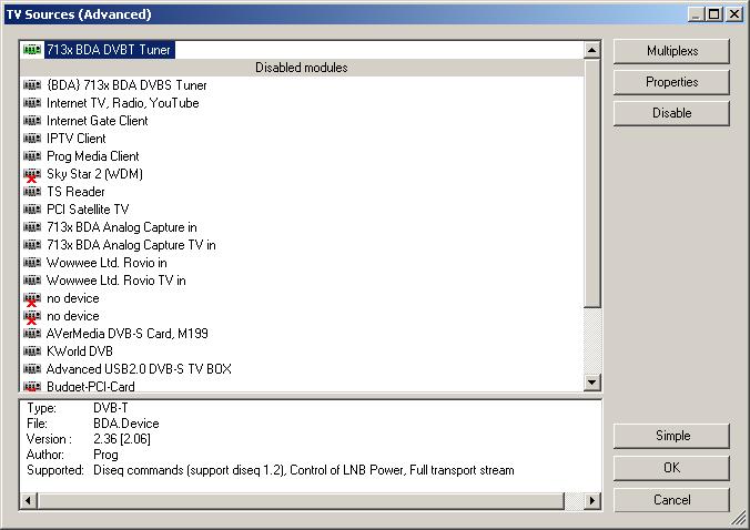

#3Hi,
thanks for the reply.
However I tried all combinations on the search screen for the card but no luck.
I have attached some screenshots for more information.
Any idea what I am doing wrong ?
Re: ProgDVB 6.65 - Blind Search - Start grayed
#4Looks like bug in interface. Please wait next version.
