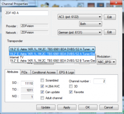

Also there is an option in the Channel Properties under Transponder where i can select the active device for the particular channel. This option decides which device is used to receive a channel.
Can i change this so it only defines the transponder and not which device is used for receiving it?
It doesn't seem to make a difference if i turn it off or on.
What does this option do exactly?

If i open the properties of a channel, i can select the device in the transponder settings. That's where i have to say which device to use.
