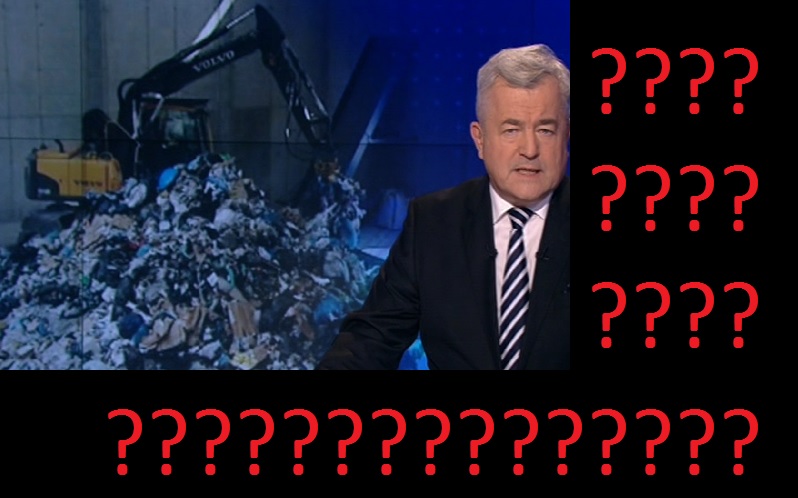

Wow! I have no idea how did you figure out this... But it works! :D
Now I have just the last problem with ProgTV... When I press [OK/Channel list] button I have this strange screen:
Did you see it before?
Many thanks!!

#25 by Prog
Is it depended from Video renderer? I am not have this problem.

#26 by cynik909
I use "Enhanced Video Render". After change to "EVR Custom Presenter" or "VMR-9 Renderless" no change :(

#27 by Prog
Do you use right menu?

#28 by cynik909
No.
I've tried to switch it in the settings but this black space appears always on the right side.
