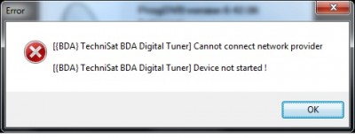

problem with progdvb 64bit
I tried to use the 64 bit version but I couldn't
It says
[sky star 2] Devise not started
I used the 32 bit version and it is working just fine,
however, I want to change to the 64 bit version
anyone can help ??
I am using the latest version of progdvb 6.42.06
and the latest version of the skystar driver 4.6.0 with win 7 64 bit

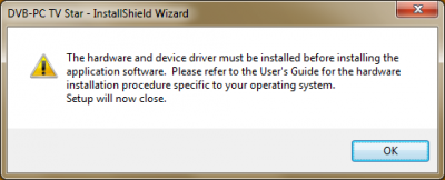

aha, I understand now, thank you :). about the WDM driver I can use it on win7 64bit but only while using progdvb 32bit.
so I installed the BDA driver correctly, but at the end, it did not work too
when I tried to run the progdvb I got that message as in the attachment

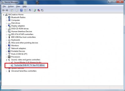

Re: problem with progdvb 64bit
#12
finally it works
the problem was that I did not run progdvb as an administrator
