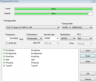

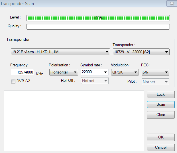

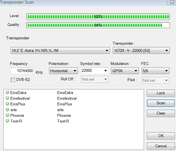

its not the same for all transponders some work some dont, did a scan as you asked me to do, ive attached the results to this post.
i pretty sure its not a alignment problem of my dish, and its a big dish. the channels are working
under mce and i can watch hd channels in progdvb on the transponders that work.
thank you very much for the help.

Please try to find out, if there's anything systematic behind transponders not working for you.
12574 H 22000 on Astra 19.2°E is nothing spectacular, normal DVB-S.
There must be some reason, of course.
Like for example, some terrestrial service interfering around 12574 - 10600 = 1974 MHz.
Do you have a mobile phone station very close to your place, or maybe a TV tower?
What's your location?
Anyway, look after the neighbour transponders,
12545 H 22000 (sat.1/ProSieben) - often effected by DECT or e-net cellular phones
12552 V 22000 (BFMTV and more)
12604 H 22000 (sky news and some WDR regionals)
Let us know on quality there.
If so, always 100% Level readings are supposed to be meaningless, perhaps due to driver limitations.
So only Quality seems to matter for you.

Re: link: 100% quality: 0%
I'm i bit confused atm, i did what you said, and suddenly all is working fine again, i didn't check if
the chanels worked before scanning the transponders, so im not sure if thats the reason for them to start
working again but thats what i did, went to the transponder that worked all the time, pressed the
lock button and started the scan, then i selected the transponders you've asked for and after a while
he found some channels on them. as said, all channels are working again..

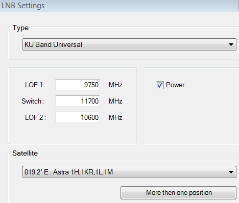

At the moment, there's one idea for a possible problem, 22kHz signal for HighBand may fail to switch on or off.
If this does not happen on another DVB software, this may perhaps be related with communication trouble between ProgDVB device and the hardware driver.
But may as well be, your value for LOF1 or LOF 2 may need a small correction, to push precisely to the transponder center frequency. It's possible, one DVB application knows to control the AFC procedure or your tujner better than the other, once giving a good lock, otherwise failing to tune in precisely.
Perhaps try to detune one or two HighBand transponders manually in 1 MHz steps up and down, to find an eventual offset between nominal transponder frequency and middle of the tuning hold range. If you can find an offset this way, don't store, but correct LOF2 for the amount found, but into the opposite direction.
Same may be necessary for LowBand / LOF1.
