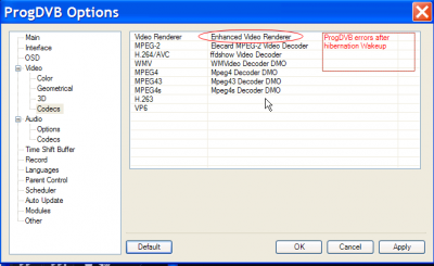

ProgDVB fails to record after hibernation wakeup, if the Video Renderer is set to 'Enhanced Video Renderer'.
So I set up a Renderer that works:
ProgDVB resets this renderer to 'Enhanced Video Renderer' at the second wakeup.
Senario: Schedule 2 records with post action 'Hibernate'. Schedule 1 starts the system, record, hibernate. Schedule 2 starts the system, ProgDVB errors, because the Renderer is set to 'Enhanced Video Renderer'.
ProgDVB Version: 6.49.09 Standard
System: Microsoft Windows XP Home Edition, Version 5.1.2600 Service Pack 3 Build 2600
Additional Hint: I'm not sure, but it may be correlated with a login after hibernate: User 'A' schedules a record with ProgDVB, system hibernate. Before the record starts, User 'B' restarts the system, system hibernate. Scheduled record starts the system and ProgDVB errors with 'your video codec is not installed' (I do not remember exactly). Reason: Video Rederer changed to 'Enhanced Video Renderer'.
