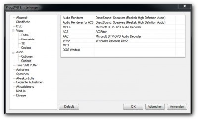

Since an update around 6.4 I got the following problems:

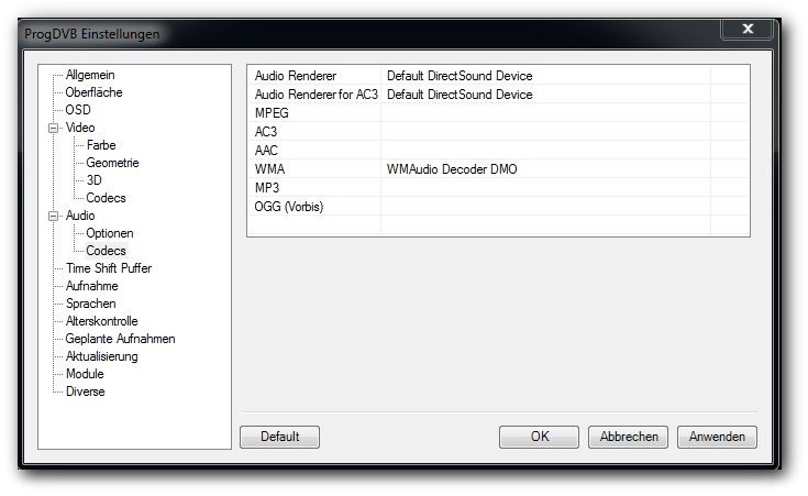

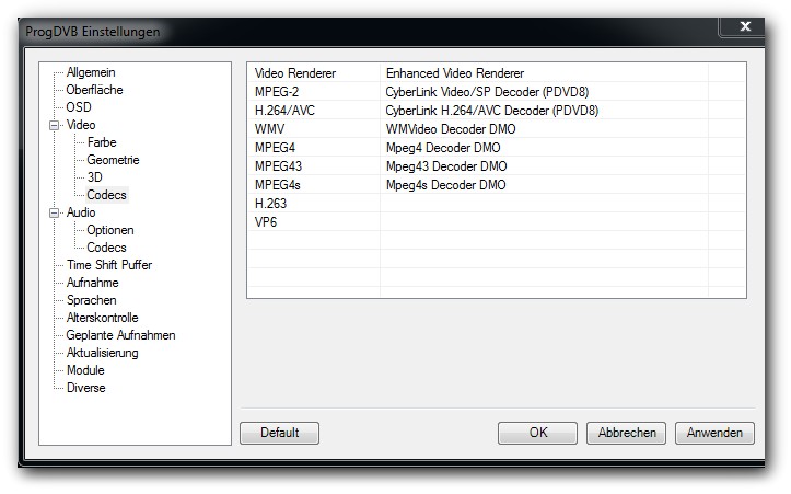

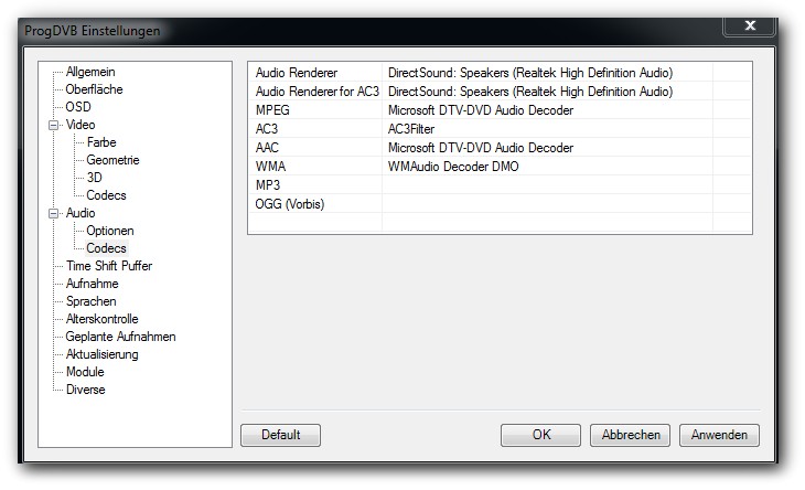

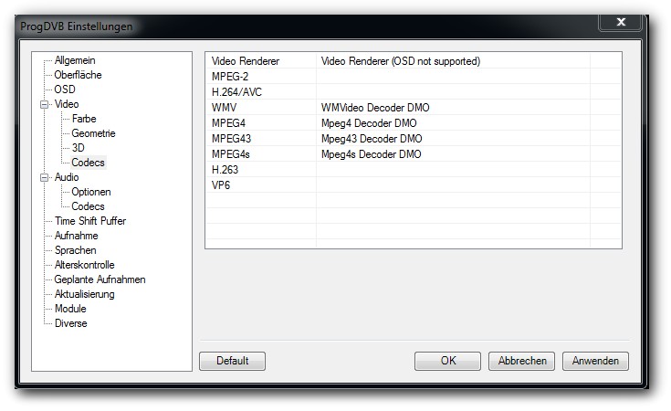

Options are not saved!
Everey time I restart ProgDVB it will come up silent and with no picture.
Options-Codecs Video-Audio: lost last settings (see pics)
Settings to default will give a picture, but no sound anymore.
pics2
pics

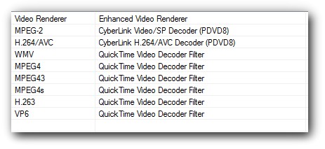

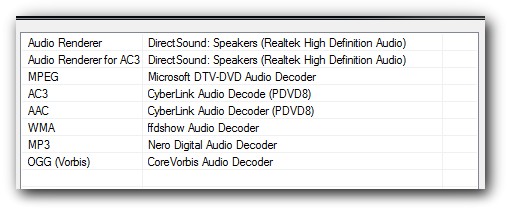

"But why codecs for mpeg and h264 not selected?"
Thats a result since ~ 6.4. Changing manually did the job so far, but closing ProgDVB and restarting columns are empty again.
Changed in 60.07 - results are stored again.
But neither video nor audio are working anymore.
"Also video render not good."
I pictured the coming-up situation. Selecting "set defaults" will fill the lines, but didnt work anymore.
Selecting manually to other codecs.

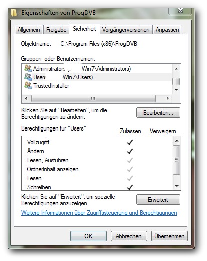

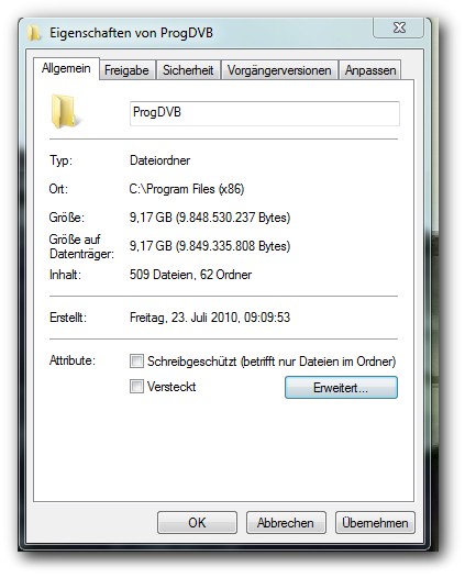

#9
good tip!

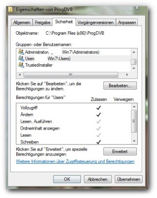

I reinstalled again to Programfiles(x86), but I changed the presetted "use ProgDVB-folder" to "Each User".
Result:
I now got back again immideatly the "normal" programs...(sd)
