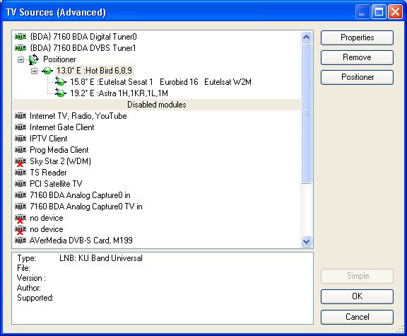

I have tried with 6.05.02 and latest, everything looks fine, no error, but the dish is not moving at all. (Optibox DM3800)
On BDA compatibility should it be lifeview or other?
This is ok?
USALS should be on?
Cheers,
Marin

#2Afaik lifeview not support positioner. Only switch. But try select Microsoft mode in Settings->Device options

#31.1 only, confirmed by lifeview support. btw. is it code or hardware 1.1 > 1.2?
If code, can other drivers correct this

#4Drivers can only be made or changed by manufacturers.
DiSEqC 1.1 and 1.2 or USALS are all followers of 1.0, not of each other. Full technical specifications of DiSEqC can be obtained for free from Eutelsat.
But this does not help here, as in fact we don't know, if it's (driver) code or firmware code or perhaps plain hardware limitation in your case.
AFAIK lifeview dont provide a SDK for your tuner, that could possibly give Prog a hint.
So, as Prog told, try Microsoft mode in Settings->Device options. Else forget about it...

#5Gave up on this Mega HD card that has no support for positioner nor it is DVB-S2 capable. A HD card
Don't forget:
Lifeview Notonlytv LV83ATS and twin called AverMedia AVerTV Satellite Trinity.
Got SkyStar HD 2, everything works from start, not really important but channel change speed is amazing.
Thank you,
Marin
