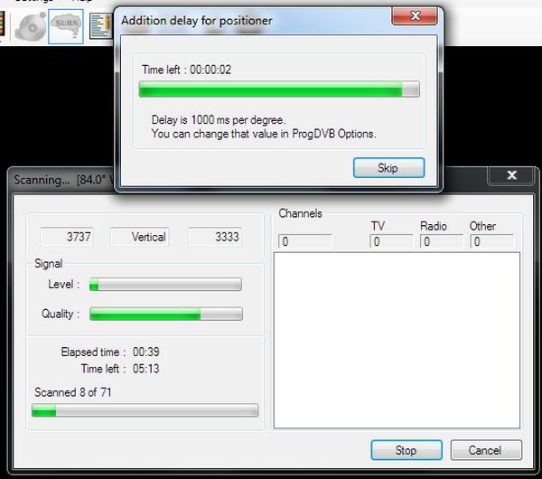

#8Sometimes i have those scan problems, too. I guess it is Progdvb not observing necessary waits for settle of devices (card, switchs, lnb, motor), before can get and read (correct) stream.
PS. The wait before scanning is not working. Scan begins immediatelly. Anyway i think this should be a additional time, beyond each device delays...

#9You can change delay in positioner dialog. But this is total other situation.
Re: Wrong scanning of sky Italia HD
#10Both delays, positioner motor delay before scan AND simple delay before scan are not working. Scan beggins immediatelly after tunning. Its not hard to see that.

#11Again. This is total other situation. In this thread your post looks like spam.

#13It seems Sky HD problems are fixed, no more talk.
A print of the screen to show the problem of positioner delay not working. Delay not run out, but scan is far going...
