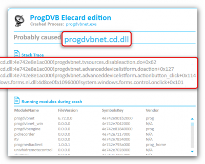

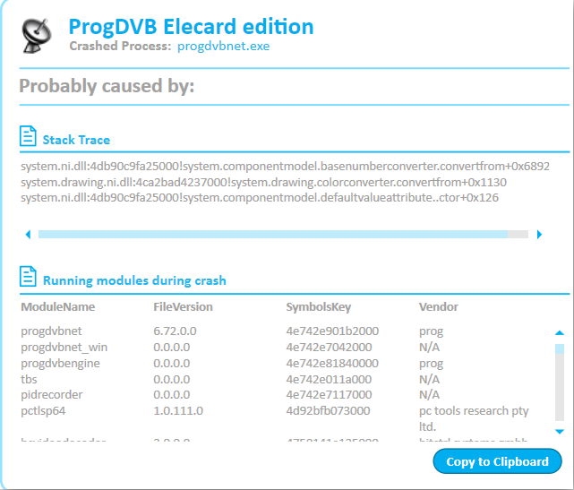

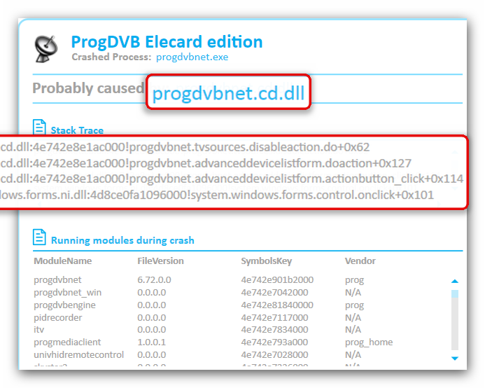

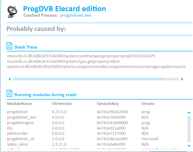

I'll put these pictures to be able to get an image what problems I have with ProgDVB when I try to scan.When I scan whatever {Channel Search, Manual Search or BlindSearch}, player crash soon when I start.I tried with other versions of ProgDVB and other TBS6925 drivers and every time the player gives me the same crash when scanning on OS Windows 7 64 bit
Could you give me from these pic. a correct diagnosis?

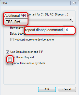

#2Do you use TBS mode? Try select MS mode or remove tbs2.ebda file.
ps: Uncheck "Use ITuner request" it is near same like direct mode. But I am still not know what API use your device. If MediaCenter is working, then Microsoft mode is good. Try change repeats value also.

#3I tried all the advice you gave me, sadly without any result:every time the player crash.Not only I have eliminated tbs2ebda file,in fact this file is TBS.eBDA2 unsuccessfully, but I deleted the other files TBS, with the same negative result.Prog wrote:Do you use TBS mode? Try select MS mode or remove tbs2.ebda file.
When I removed tbs.eba2, I received the following report about the crash.Maybe this report can help you understand better than me where does crash.
I will put other pictures with ProDVB settings to have an image about what is configuration of this player on my OS Windows 7 64 bit.
After I installed and uninstalled several versions of fresh ProgDVB, following your advice but also other possible configurations.Incidentally, MediaCenter is working.
