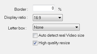

by grobnik
The Geometry option, below indicated setting are not specific for such channel, but are setting in general option menu:
Border 0%
Video Ratio None
adjustment None
(the above option are in translated from Italian language, so could not be the same in english software version).
Re: ProgDVB - Free
Posted: Sun Feb 12, 2012 8:21 pm
Display ratio-real proportions of screen/Right click-auto/
All above-provider fault
