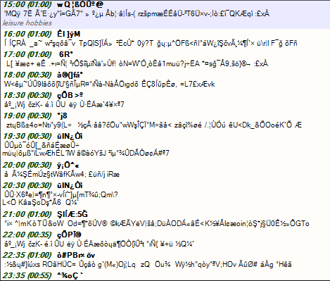

T2 hd channels have no sound and scrambled program info
#1 by CommanderLake
as the title says.

scrambled epg on T2 HD channel

codepage problems... Please record me 4-5 minutes sample in Service->Pid records->All TS from this transponder.
File is big but you can put on my ftp.

Thanks for interesting sample. I am not know this type of codepage(compression?) of EPG but try fix this in one of next version.

Crypted?
http://www.technovia.co.uk/2010/06/dumb ... es-do.html

I check again. This is LATM AAC audio format. Now all AAC codecs support LATM, but divx is good. I on my PC your sample playback without problems (exclude encrypted EPG)
