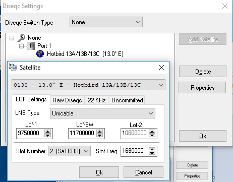

I cannot force my unicable converter to work properly.
It is Inverto IDLU-QUDL42-UNR2L-1PP with 4 fequencies : 1 - 1680 MHz , 2 - 1420 MHz, 3 - 2040 MHz, 4 - 1210 MHz.
My card is TBS 6902.
By manipulaton with LOF, I can get signal from one transponder.
For example 11508 - LOF(10088) = 1420.
Please help me with settings.

If it can help, I've checked if my card or LNB are not broken.
Here my setting which works in another program.

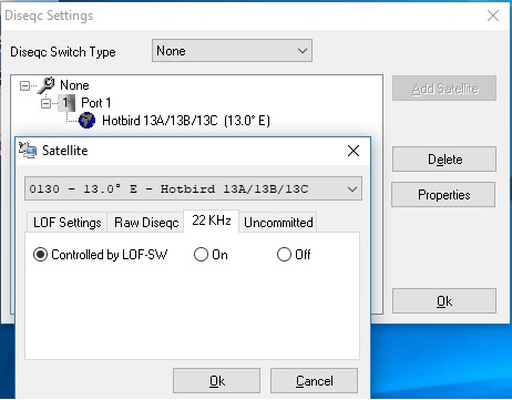

Also 22 KHz setting must be "Controlled by LOF-SW". Without this setting, I was able to reach only 11700 (LOF-SW) frequency.

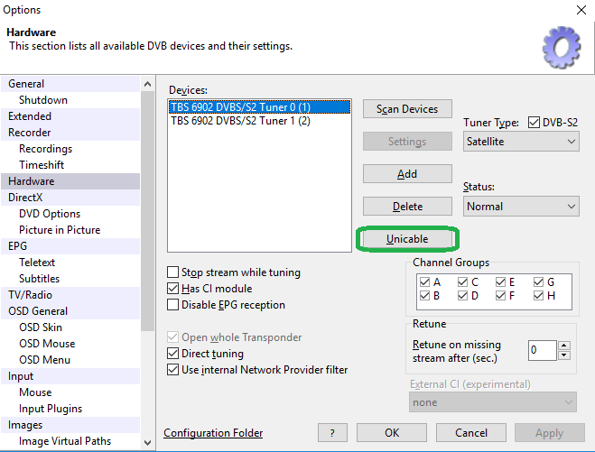

DVB Viewer:
1. You have to select device then LNB. There is no Unicable configuration in this step. Just Ku-linear/universal
2. Go to option and cllick Unicable button.
3. Provide slot fequency. Again I select 1420.
Above configurations bind tuner to slot frequency. My configuration would be: Ariva 253 -> 1210; TS6902 tuner 1 -> 1420; TS6902 tuner 2 -> 1680.
