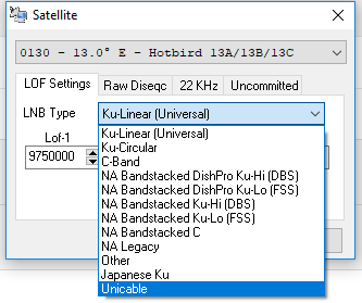

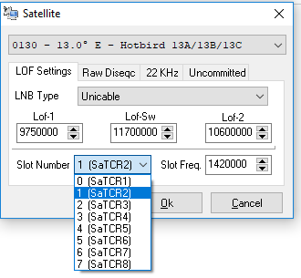

If it can help, I've checked if my card or LNB are not broken.
Here my setting which works in another program.
Also 22 KHz setting must be "Controlled by LOF-SW". Without this setting, I was able to reach only 11700 (LOF-SW) frequency.
