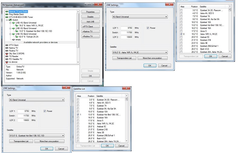

Give me screen of TV Sources
  • Tue Feb 11, 2014 4:58 pm
mrsad
mrsad
15
Mon Feb 03, 2014 1:40 pm
Re: No digital channels
#8 by mrsad
here are my TV Sources
  • Tue Feb 11, 2014 6:58 pm
26099
#9 by Prog
Looks good. Try change mode in Settings->Device options. Must be Azurewave but techistat and Microsoft possible good also.

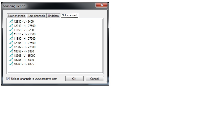

#10 by mrsad
Hello I have now scanned with Microsoft BDA and it looks better now. now
I have a lot more channels but there are still transponders which are not searched.
Thanks for previous help

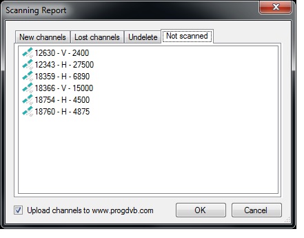

Hello I have now scanned with Technisat BDA and it now looks even better.
Now only 6 transponders which are not searched
