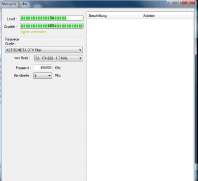

I tried both. When I type in a known frequence, it says there is a signal. Than I press "search" - and nothing happens. I know that a tv-station is sending right here on exactly that frequence. So what can I do to make ProgDVB remember, that there is something on this channel?
@Thex: But my one is not a stick for DVB-T+C but only for DVB-T. ;)

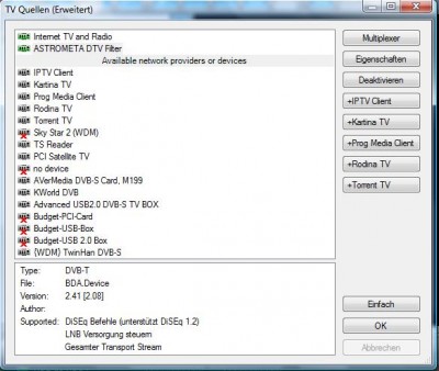

@Thex: The screenshot is attached. Hope that helps.
screenshot of Settings->TV sources
