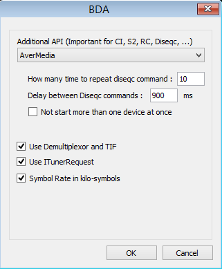

#3i have changed it from Anysee to AverMedia
and too many changes in "TV sources"
but noting work
what i can try else
but noting work
what i can try else
- prog.png (8.45 KiB) Viewed 6971 times
Re: Problem with diseqc switch 1.0
#5i did on too many different names included (Microsoft Compliment BDA Driver and Anysee)
Please any salutation, iam tired from this.
#6try use anysee.Device in base of bda.device. But I am not test that...
#7noting work
please is this any way to use Teamviewer for remote management ?

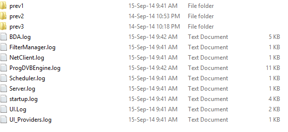

#8Send me logs with anysee.device. (Settings->Options->Debug->Logs)
#922:18:38.811 -
