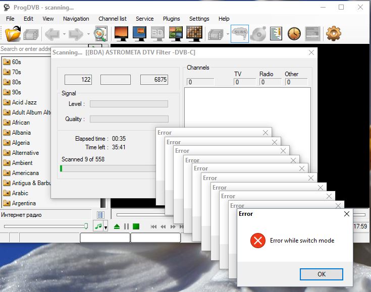

16.0 Completely broken.
I was excited to see huge fixes for astrometa tuners. Yet all I got was nothing. Just an error message repeating endlessly, no matter which channel I try to switch to:

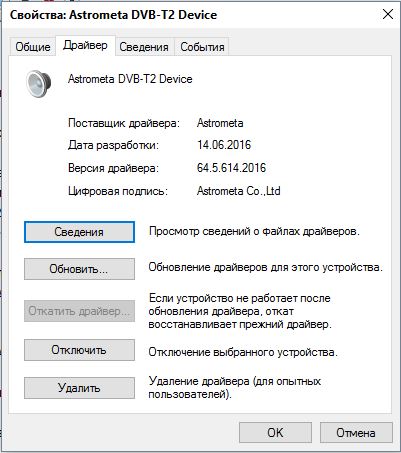

#2What tuner type you use? Try install last driver.
#3Astrometa DVB-C, I already have the latest driver.Prog wrote:What tuner type you use? Try install last driver.
#4What last good version of ProgDVB?

#5I'm using 7.15.3.Prog wrote:What last good version of ProgDVB?
I am not have cable and not can test signal. But not errors.
Please try disable tuner in TV Sources and enable again.
Disabling/enabling doesn't help. All I ever get is the error.

#87.16b have same problem. Revert to 7.15.3.

#10of course. I have tried use only DVB-C or DVB-T2, but same error.Prog wrote:Do you try disable tuner in TV Sources and enable again?

#11Hm. Please send me logs after this error (Enable Options->Debug->Logs before that).

#14Hi!Prog wrote:Please test "b" prerelease and send me logs if still error.

#15I tried it. It seems to work now. I don't get the error.Prog wrote:Thanks! Please try "c" prerelease.
