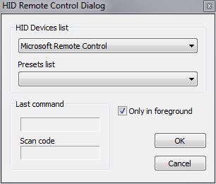

#7Hi Prog,Prog wrote:Check "only foreground" in HID module options. Sorry for this bug
I've checked it before posting here. Unfortunately it doesn't work for me

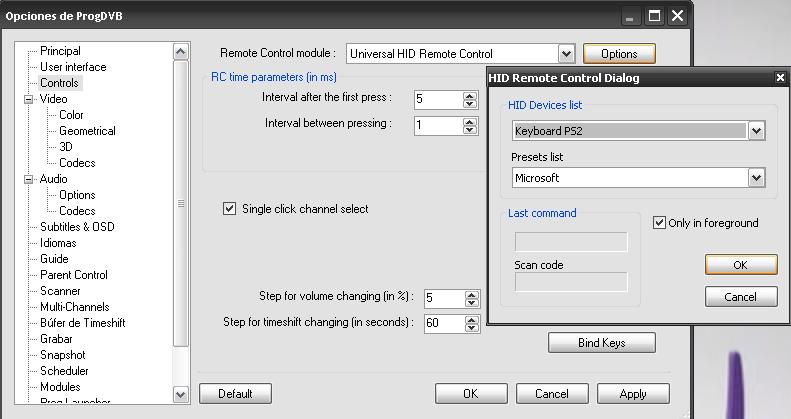

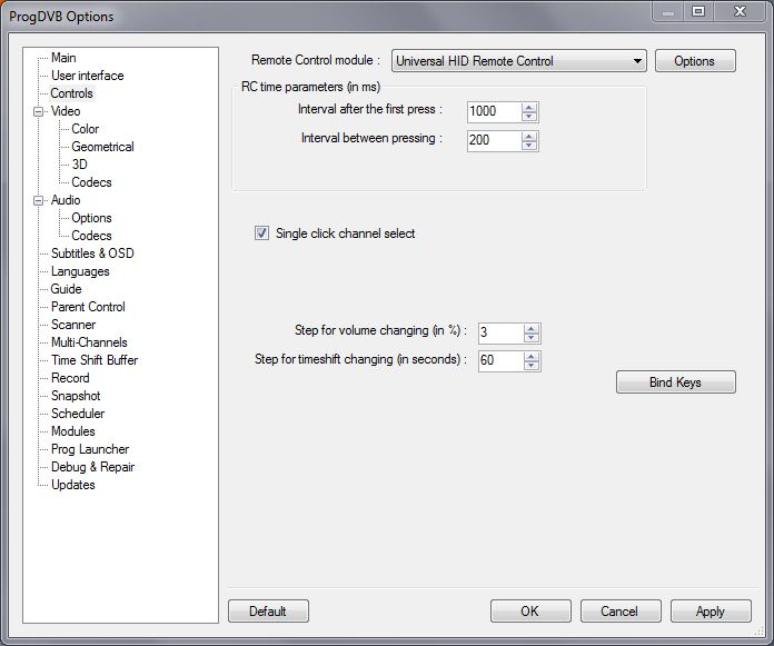

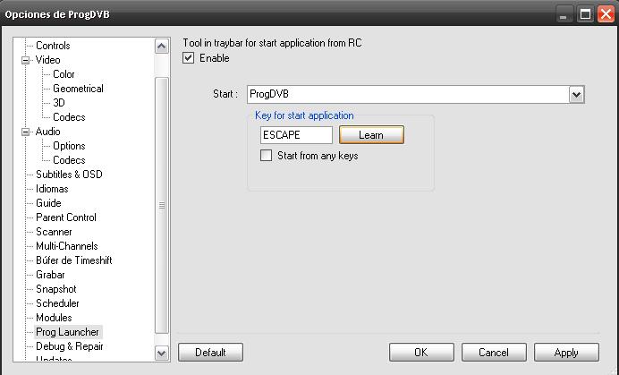

#9Please send me screen of HID and ProgLauncher settings. I am not can repeat this.
Re: Problem with shift-key
#10here they are (is this what you want).
Please note that none of shift, alt & altgr keys work when Remote control module is set to Universal HID Remote Control.
Regards
Regards

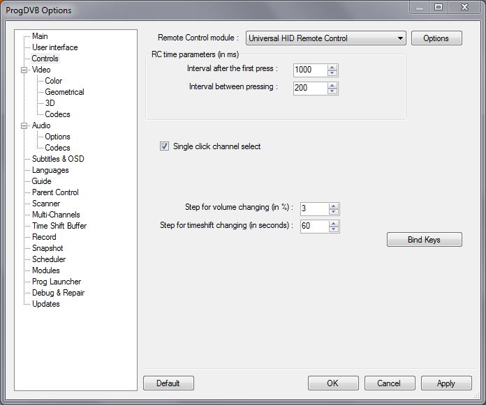

#13I've tried. No changes in my caseProg wrote:Please try (a) prerelease.
