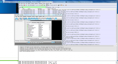

#139install Wireshark and you see all rtsp Messages rtp rtcp the full communication if you Need help with wireshark let it me knowevarost wrote:Hi Prog,Prog wrote:Still wait result of last prerelease. I think that is good.

Re: SAT>IP Protocol support
#146Hi Prog,
I found where is the problem with the channel change using the "tune" commands.
Please, see the secion "A1.3 Channel Change Implementation" page 61 of the standard specification (http://www.satip.info/sites/satip/files ... on_1_2.pdf):
As you can see here, when a channel change is requested, no TEARDOWN command is send. Also no new SETUP or OPTIONS is send. Only a new Play!
The logic that I understand is:
1) Setup the tuner, using SETUP command. This reserves a tuner for you, and the server assigns to you a streamID (com.ses.streamID, not the RTSP Session).
2) You start to receive the stream sending a PLAY command over the stream.
3) When you like to change the tuner parameters, you send a new PLAY command using the same streamID and the new parameters.
4) You can repeat as many times as you like.
5) When you like to free the tuner, you send a TEARDOWN command over the stream.
Please, can you implement this different logic?
I hope I don't disturb you. Thank you for your support!

yes that i say/write yesterday to prog in emails that the Setup Play Options all is what he Need and teardown as last command
and today morning have i send him a link http://1drv.ms/1nThzd9 to him this capture Shows how it can be used
without comment at time
