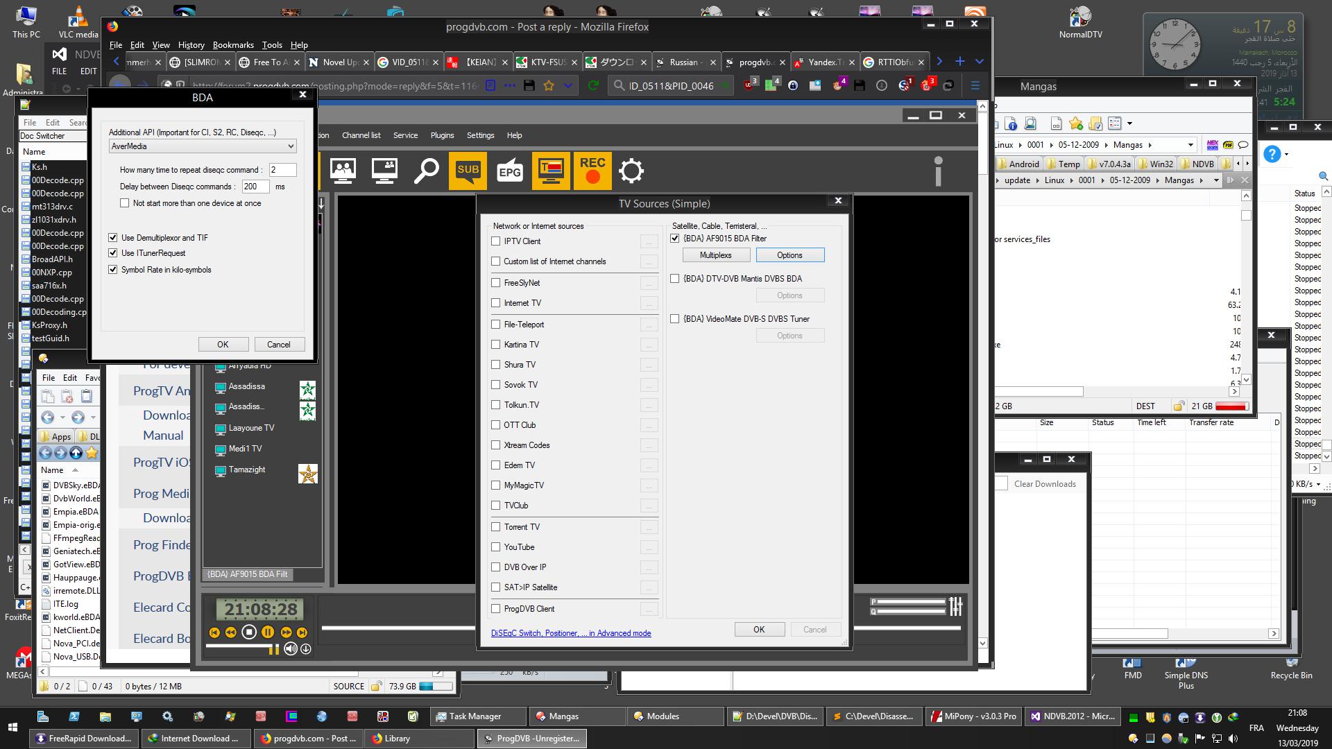

#25
You can enter manually the value of the PLP on the field that contain "All" text (you can enter a numeric value in it). You must choose "Avermedia" (Because you modified Avermedia.eBDA) in the extension used by the Card.
It doesn't matter what module you use (I used empia.eBDA) for my testing, so I don't think you should use 'Avermedia.eBDA' specifically.
Try using the empia.eBDA module just to be sure .

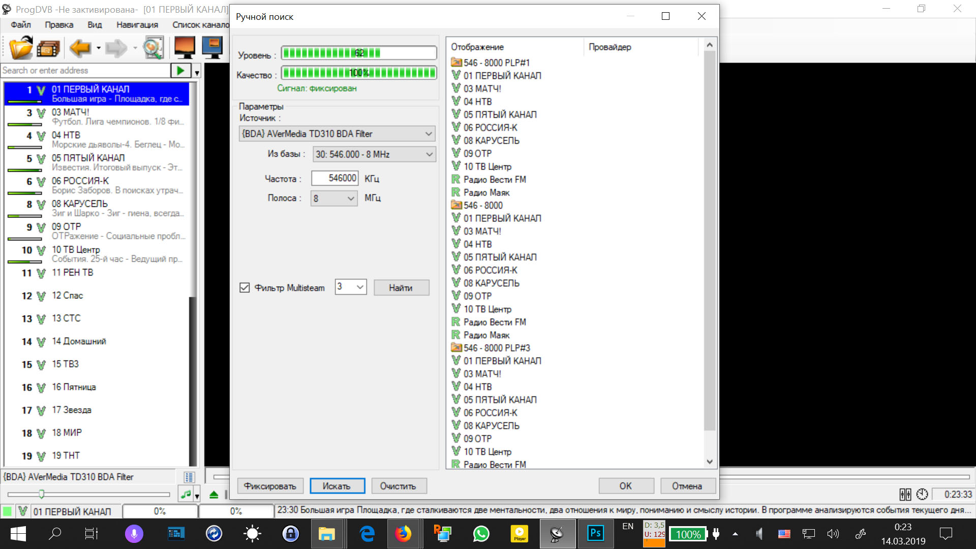

#27
So it work, but not all PLPs are found if I understand you correctly ?
Without the "ITE.log", I would not know what's happening in the module itself, because I don't have the full progDVB eBDA module API, I'm just guessing and testing too.
From the image, I guess it's not working, I really need that "ITE.log" to see if the Card extension is working or not.

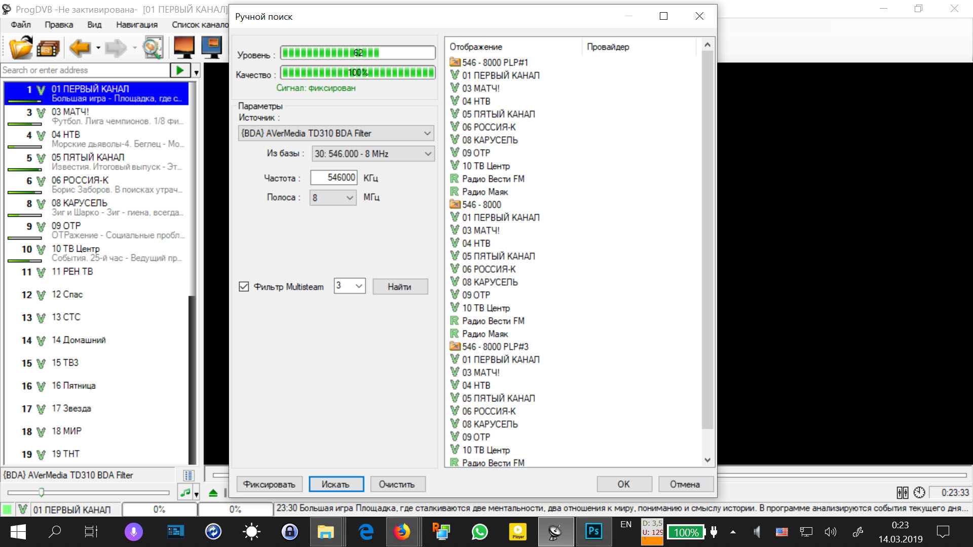

#28
crackname wrote: ↑
Wed Mar 13, 2019 9:31 pm
Well, yes, as I understand it, the program finds only the multiplex of channels from PLP 0. In Russia, some channels are still being broadcast in PLP 1 and 2 in Russia.
